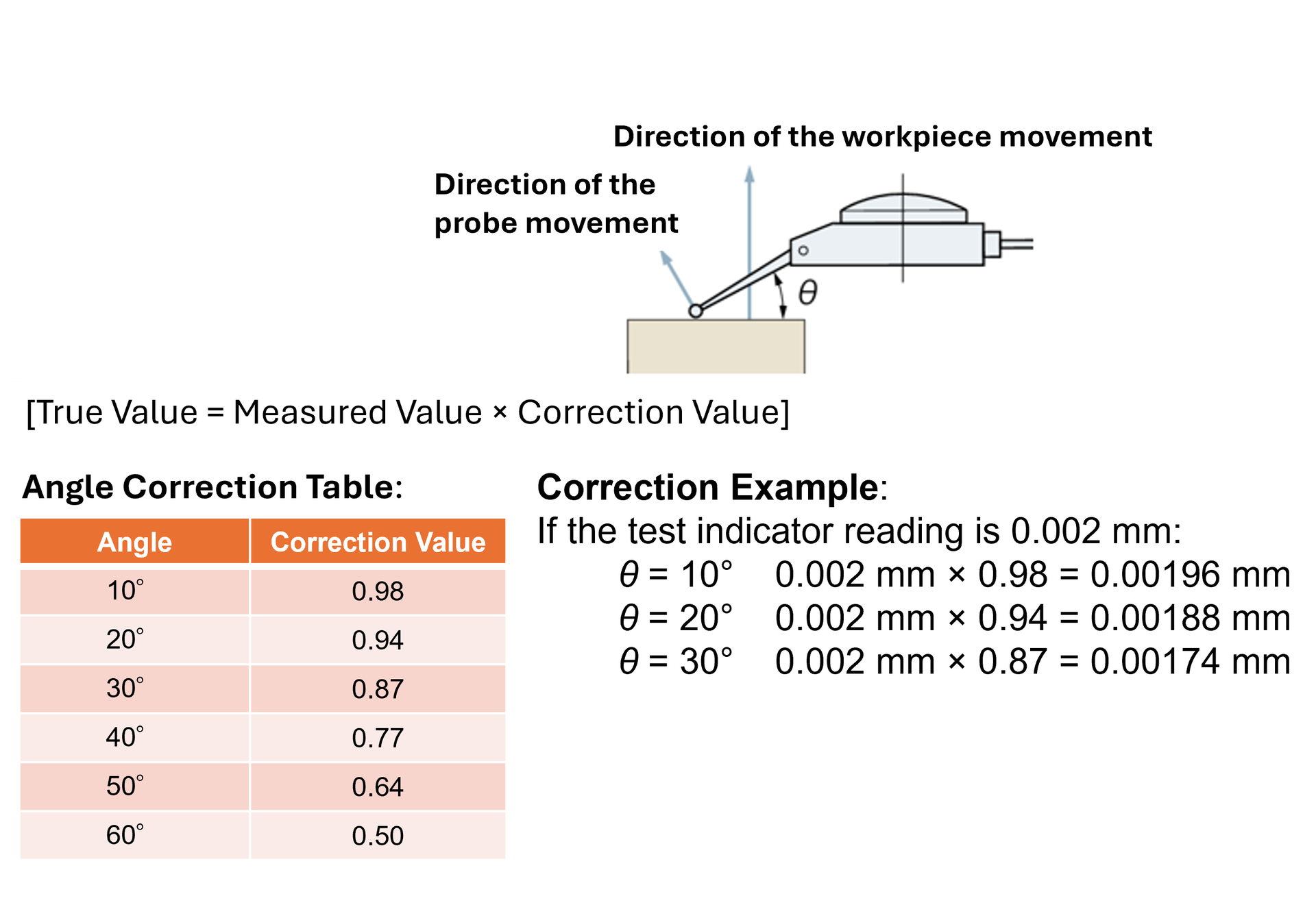

  • Clean the measuring instrument thoroughly before use.
  • Minimize cosine error by keeping the contact angle as close to parallel with the measured surface as possible—without causing shanking.
  • Always view the indicator reading straight on to avoid parallax errors.
  • Use a contact point that matches the exact length specified for your model to ensure measurement accuracy.

What should I do if the measuring instrument is not positioned at the correct angle?
If the measuring instrument is set at an angle, the measured value may be inaccurate. To obtain the correct result, apply an appropriate correction based on the measurement angle.
