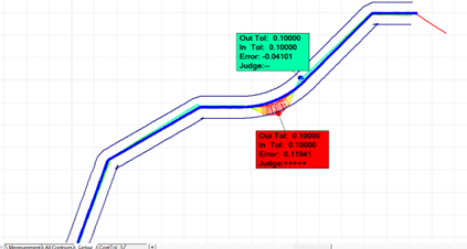

2. Profile Radius—Especially at Seams and Tabs
The radius of the can profile, especially in the double seam and pull-tab areas, must be tightly controlled to prevent leaks, breakage, or consumer complaints.
Mitutoyo Solution:
Define precise tolerance bands using the FORMTRACER Avant H4D4000 and automate inspections via built-in part programs. Gain the confidence of more QA sign-offs and reduce the risk of out-of-spec shipments.
                                                            ** Tolerance Band Made From Actual Canning Mold **

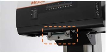

Mitutoyo Solution:
The Avant Series enables hot-swapping between contour and roughness heads in less than 30 seconds, allowing quick transitions from shape to texture measurement—without tools or calibration delay.
