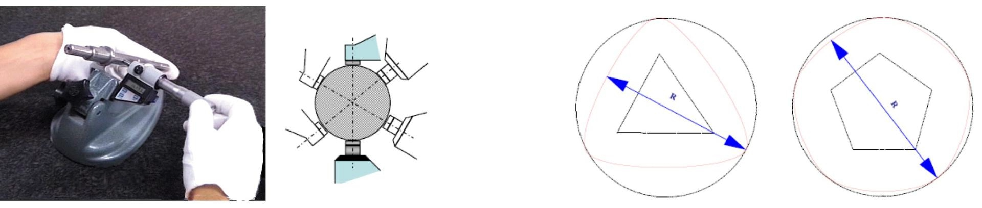

①Diameter Method
  • Measure the diameter of a single bearing section using a micrometer, and use the maximum and minimum diameter values to calculate roundness.
    *Formula: (Maximum Diameter Value - Minimum Diameter Value) ÷ 2
  • For drilling applications, a cylinder gauge is commonly used.
  • In cases of circular distortion with equal diameter (see Figure 4), the calculated value tends to be smaller than the actual value.
  • The actual cross-sectional shape cannot be determined using this method.
Figure 3                    Figure 4
②Three-Point Method
  • Place the shaft on a V-block and apply a micrometer and measure the deflection as the shaft is rotated.
    The amount of deflection is used to determine roundness (refer to Figure 5).
  • Sensitivity may vary depending on the cross-sectional shape of the shaft (refer to Figure 6).
Figure 5                                   Figure 6

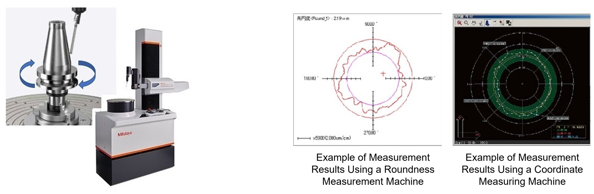

③Radius Method
  • Utilize a roundness measuring machine or similar device to obtain the unevenness of the entire circumference.
    Calculate roundness using the collected data (refer to Figure 7).
  • Roundness is determined from the cross-sectional shape of the entire circumference, allowing evaluation based on JIS standards (refer to Figure 8).
  • When using a three-dimensional or image measuring machine, diameter measurement can also be performed simultaneously.
Figure 7                    Figure 8
