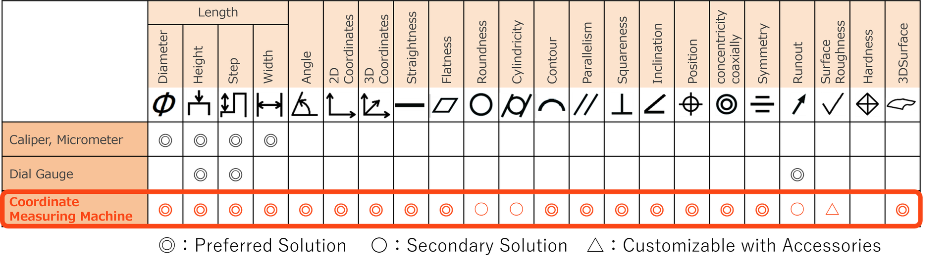

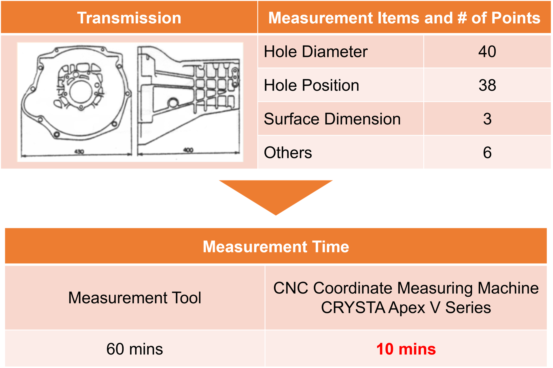

Is changing inspection setups taking too long because of geometric tolerances required on your drawings?
Coordinate Measuring Machines are highly versatile, and with standard contact probes, they can cover nearly all the inspection items specified in the drawing—except for roughness.
By utilizing a CMM, you can significantly reduce both the time needed to adjust your inspection setup and the effort required to prepare working standards.
The Crysta-Apex V Series can handle all the inspection items specified in the drawing, by greatly reducing the time required for setting up the inspection process.
