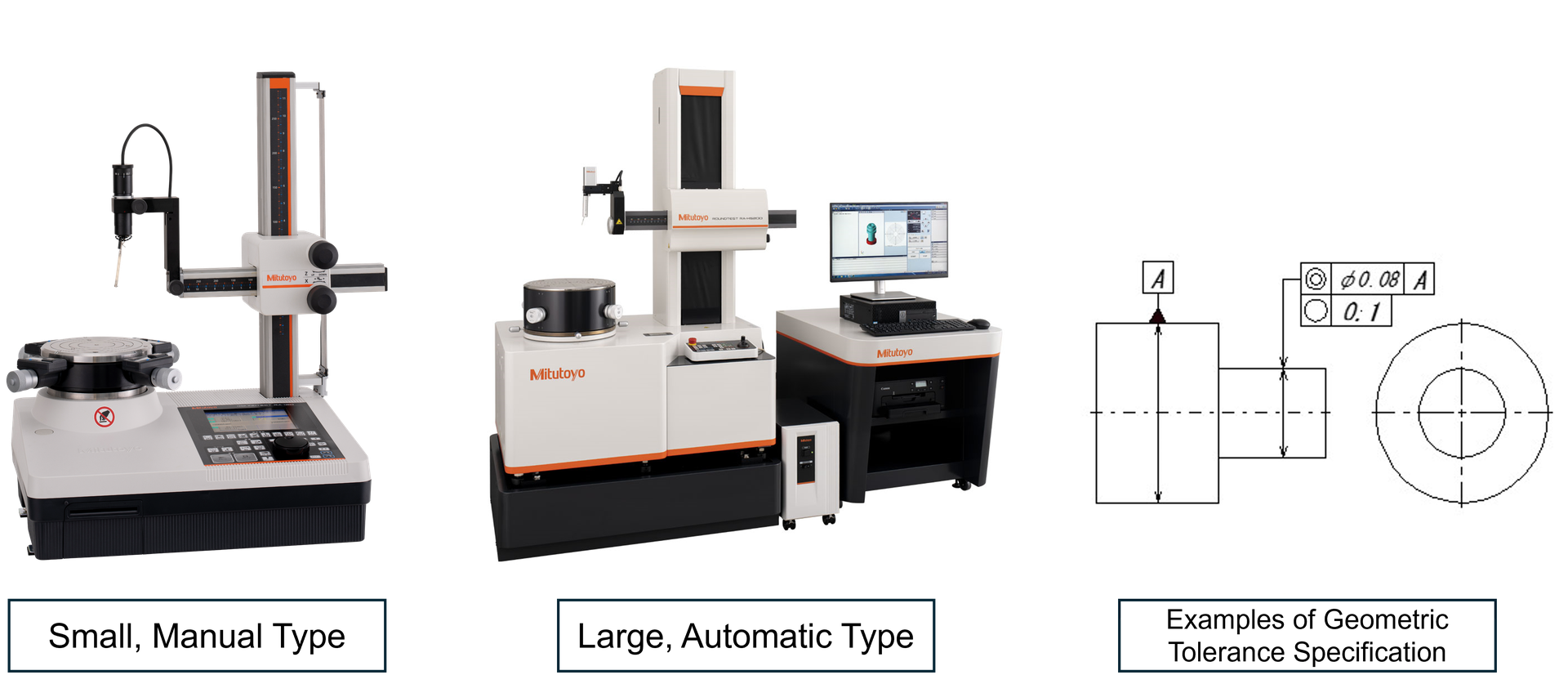

  • A roundness measuring machine is designed to measure the geometric tolerances of cylindrical and disk-shaped objects. It accurately evaluates parameters such as roundness, cylindricality, and coaxiality (concentricity), etc.
  • The most common type involves rotating the object on a rotating table to accurately capture fine unevenness around the entire circumference.

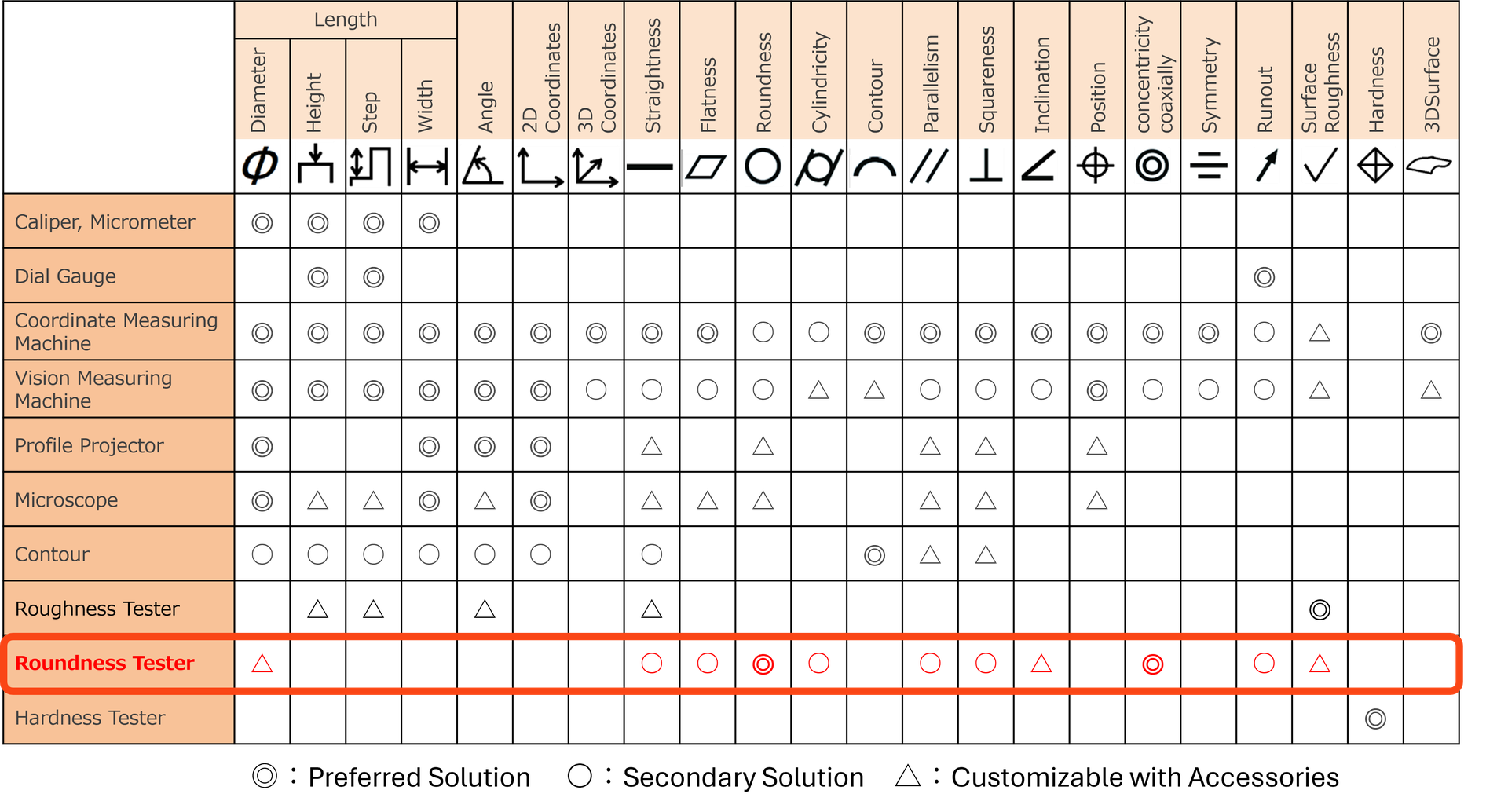

Items Measurable with a Roundness Measuring Machine
Key Point:The roundness measuring machine evaluates the geometric tolerance of a circular cross section.

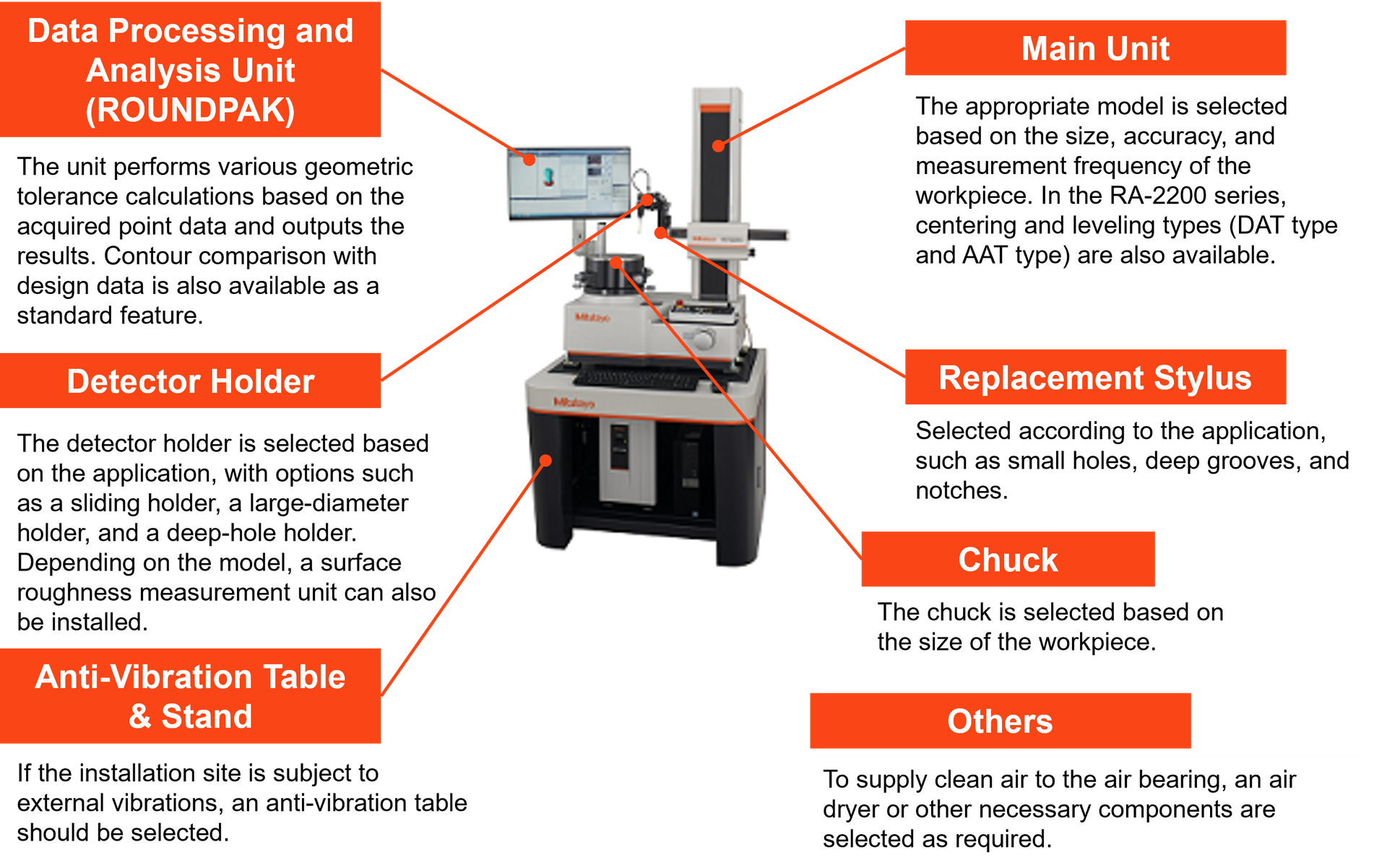

System Configuration

ROUNDTRACER EXTREME - Roundness/Cylindrical Shape Measuring System
The ROUNDTRACER EXTREME provides exceptional repeatability in roundness and cylindrical shape measurements while also measuring surface roughness and contours, making it perfect for evaluating prototype shaft-type products.
ROUNDTRACER FLASH - Non-Contact Cylindrical Shape Measuring Machine
The ROUNDTRACER FLASH is a high-performance non-contact cylindrical shape measuring system that rapidly captures complete workpiece data with multiple image sensors and a rotating table, enabling precise measurement of dimensions, steps, and geometric tolerances in a single unit.
