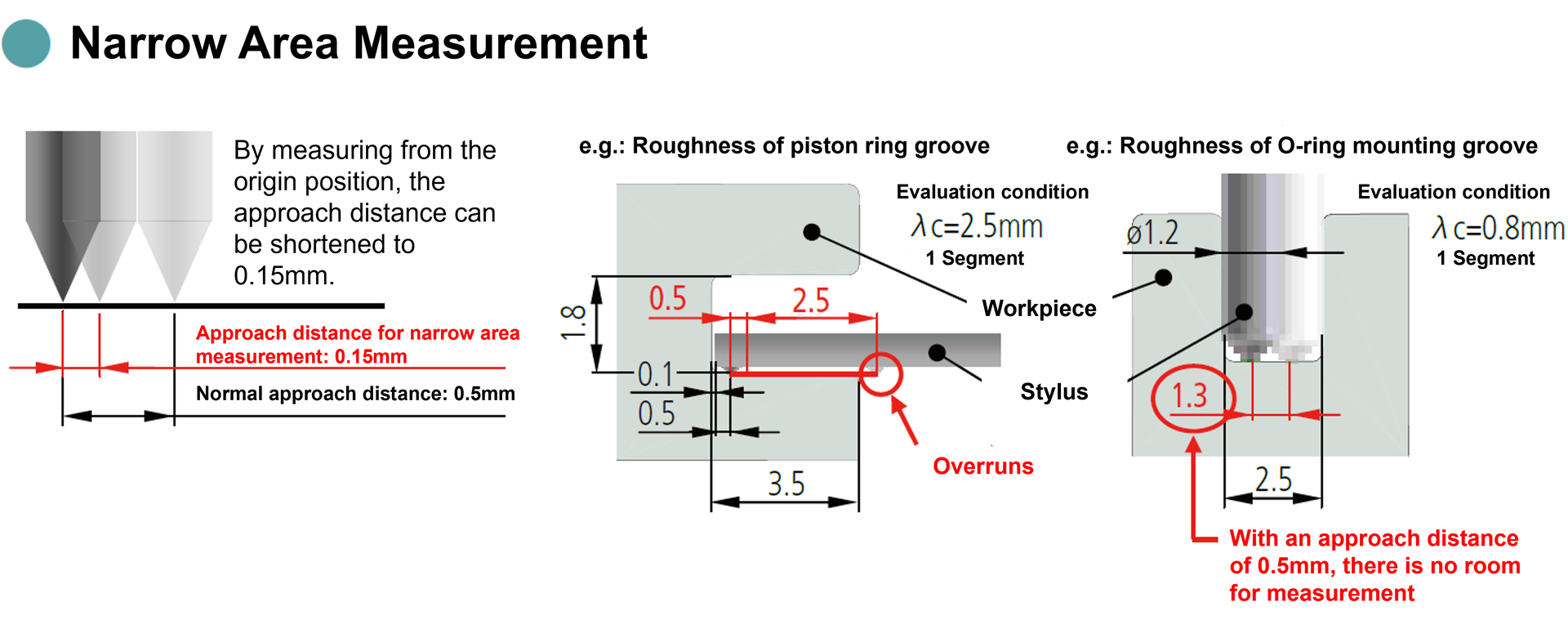

Mitutoyo's compact surface roughness measuring machine offers a variety of stylus shapes, enabling it to handle special shapes at a low cost. Additionally, its reduced run-up distance of just 0.15 mm allows for precise measurements in narrow and intricate areas, making it an ideal choice for detailed measurement requirements.
A variety of stylus shapes, including those designed for small holes and deep grooves, can be utilized to meet new requirements cost-effectively.
It is capable of measuring narrow areas, making it suitable for meeting increasingly stringent inspection requirements.
