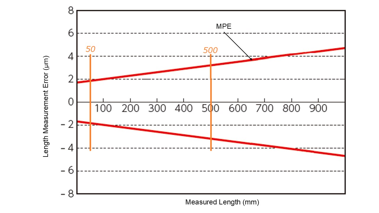

The MPE is the specified limit of error, or accuracy, across the instrument measuring range as show in Figure 1.

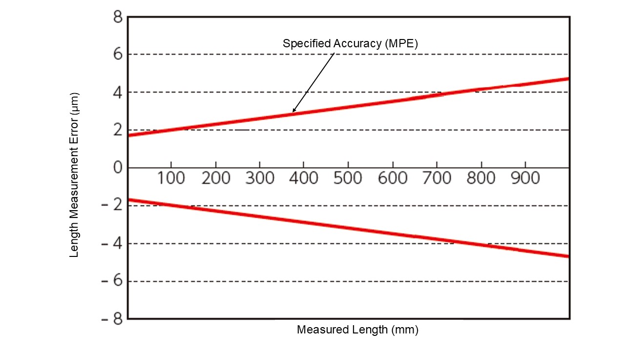

  • The specified accuracy is calculated by substituting the actual measured length into a mathematical formula (Figure 2).
    MPE =1.7+3 L/1,000 (μm)        L= measured length (mm)
    i.e. (1): When measuring a length of 50 mm ・・・
                 MPE =1.7+3×50/1, 000=1.85 μm
    i.e. (2): When measuring a length of 500 mm ・・・
                 MPE =1.7+3×500/1,000=3.2 μm

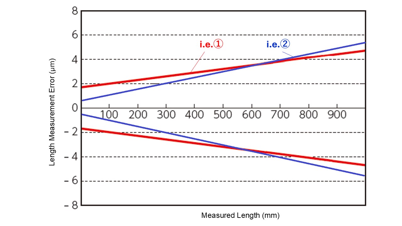

When comparing the accuracy of measuring instruments, calculate not only the initial term.
(1.7 μm in the above example) but also the contribution from the measured length. For comparison please review (Figure 3.).
i.e.①:MPE =1.7+3 L/1,000 (μm)        L= measured length (mm)
           →MPE =4.7 μm when measuring 1,000 mm
i.e.②: MPE =0.7+5 L/1,000 (μm)        L= measured length (mm)
           →MPE =5.7 μm when measuring 1,000 mm
