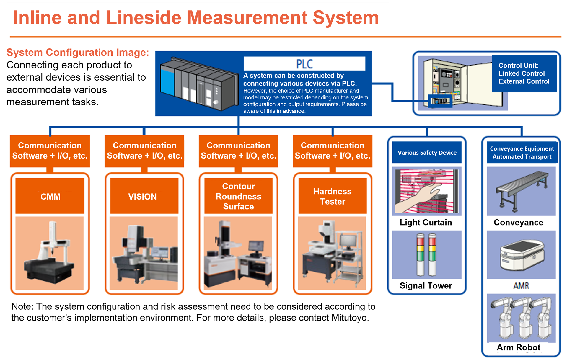

Seamless Automation for 24-Hour Precision Measurement
Are your precision measurement processes still reliant on manual operations, requiring workers to frequently replace objects?
With our solution, you can fully automate the process by integrating a CNC Vision Measuring Machine with a carrier system. This setup enables seamless transitions, handling everything from object conveyance and precision measurement to OK/NG judgment and transfer to the next stage.
Thanks to our extensive expertise, we can customize the ideal automation solution to meet your specific needs. Let Mitutoyo help you unlock continuous, efficient operation—consult with us today!
