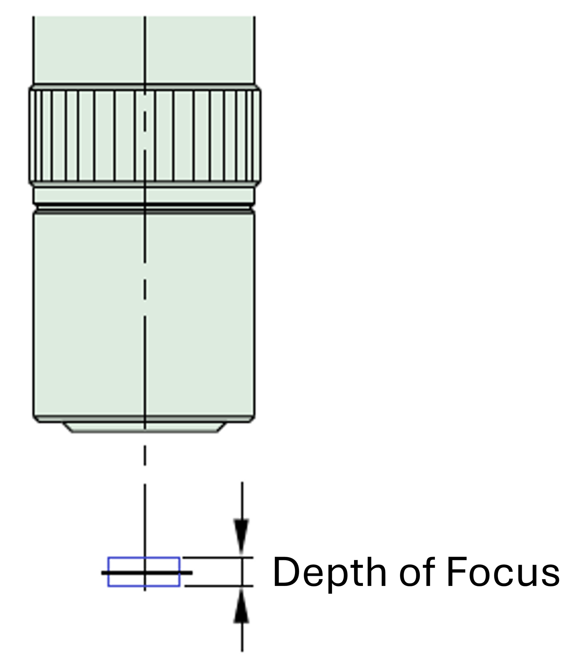

  • Depth of focus refers to the range within which the optics or image sensor can move while still maintaining a sharp image. Not to be confused with depth of field, which refers to the range that appears in focus without moving the sensor.(Figure 1)
  • Also known as D.O.F. (Depth of Focus)
  • In general, the higher the magnification of the objective lens, the shallower the depth of focus.
  • Because the human eye adjusts differently from person to person, the perceived depth of focus varies from person to person.
Figure 1
