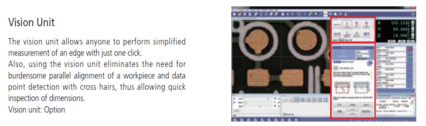

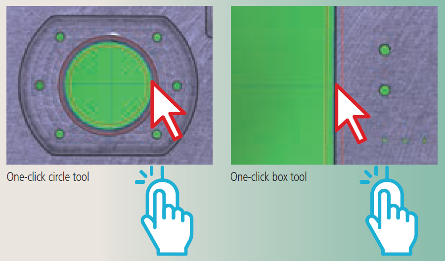

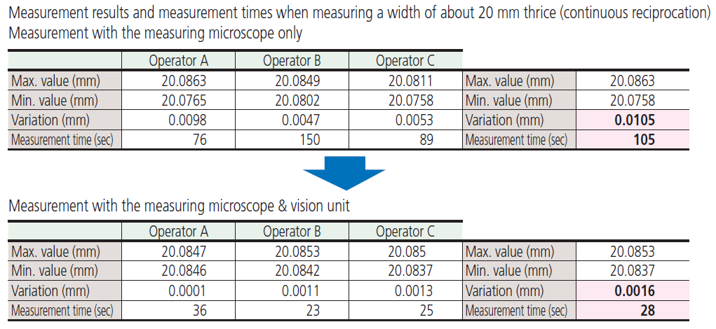

Measures to Address Variations in Measurement Points
Obtaining measurement points using a crosshair can result in inconsistencies, such as measuring at the end of a line or at its center, leading to variations depending on the operator.
Three key measures can address this issue:
・Improve and standardize inspection skills through training and defined work procedures.
・Enhance edge visibility at measurement points using optimal lighting.
・Minimize individual error by leveraging automatic acquisition through image measurement functionality.
Mitutoyo's image measurement function simplifies the process of obtaining accurate measurement points, significantly reducing variations.
  *For increased certainty in measurement accuracy, the MF series is recommended, delivering precision that approaches JIS 0 grade.

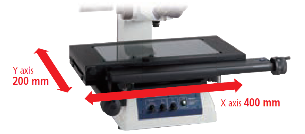

Measures to Prevent Errors from Improper Fitting of Measurement Objects
When a measurement object does not fit on the stage, its fixation becomes unstable, resulting in measurement errors.
Two key measures can address this issue:
・Examine the object before assembly and cut it to a size that fits the stage.
・Replace the current system with a measuring microscope equipped with a larger stage.
Mitutoyo offers a wide range of microscopes designed to accommodate larger objects without the need for cutting:
*XY direction: up to 400 x 200 mm
*Z direction: up to 220 mm

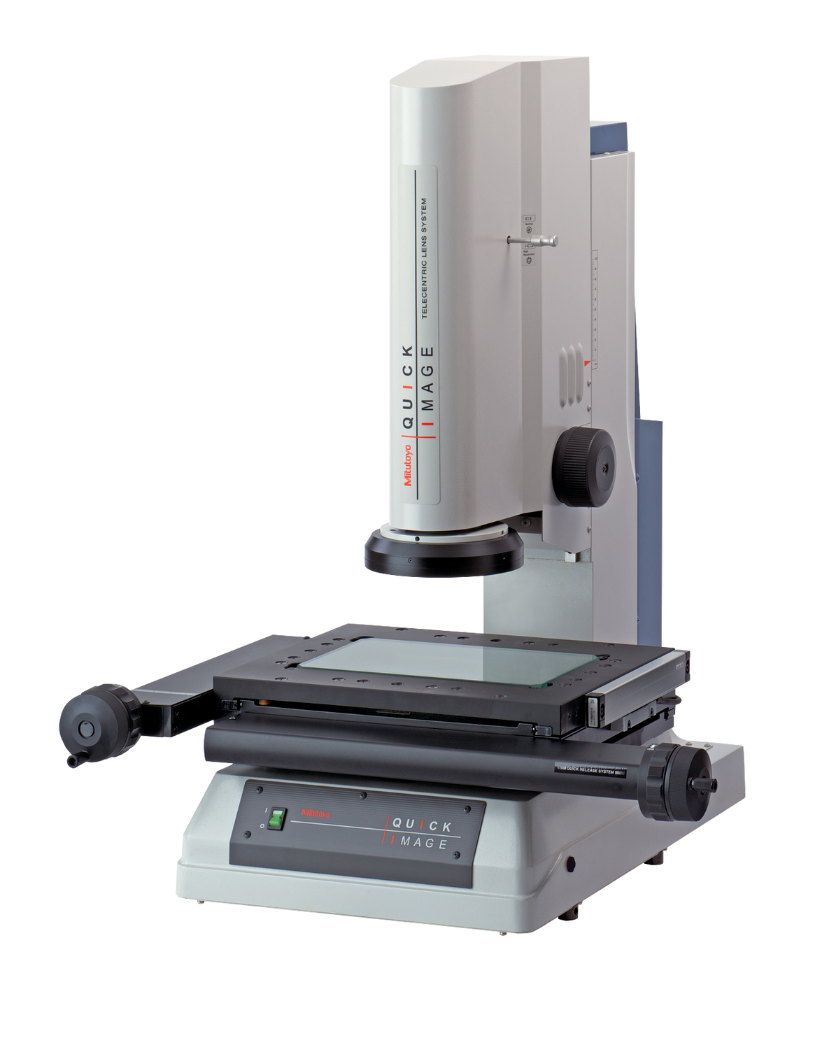

Quick Image - Manual Vision Measuring System
The Quick Image is a manual image measuring system designed for convenient shipping inspections. With a single click, it efficiently measures multiple workpieces on the screen using advanced pattern-searching capabilities.
