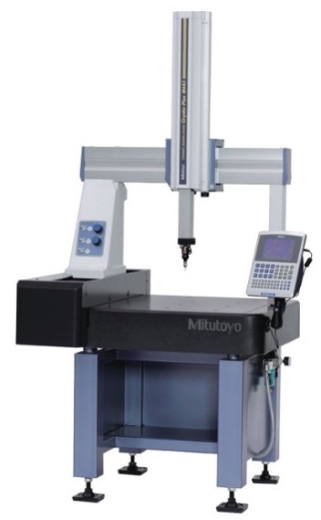

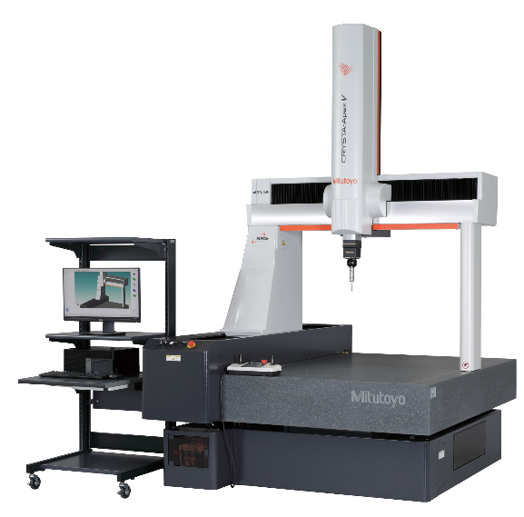

What is a Coordinate Measuring Machine?
A Coordinate Measuring Machine (CMM) is a precision instrument used to measure the physical geometrical characteristics of an object. It operates by using a probe to contact the surface of the object at various points, recording precise coordinates (X, Y, and Z) for accurate dimensional measurement. The probes used in CMMs can vary depending on the application: a tactile probe makes contact with the object's surface, a scanning probe continuously measures a surface, an optical probe uses light to measure dimensions without physical contact, a laser probe utilizes laser beams for high-speed, non-contact measurement, and a roughness probe is designed to assess the surface texture and roughness. CMMs are widely used in manufacturing and quality control to ensure parts adhere to exact specifications, enabling detailed inspection and detection of defects.
There are different types of CMMs, such as:
• Manual CMM: These require an operator to manually move a probe to the points of interest on the part being measured.
• Motorized or Automated CMM: These are computer-controlled machines that automatically move the probe to the required points on the part, making the process faster and more precise.
• Portable CMM: These are smaller and can be moved to various locations, often used for larger parts or items that cannot be easily placed on a traditional CMM.

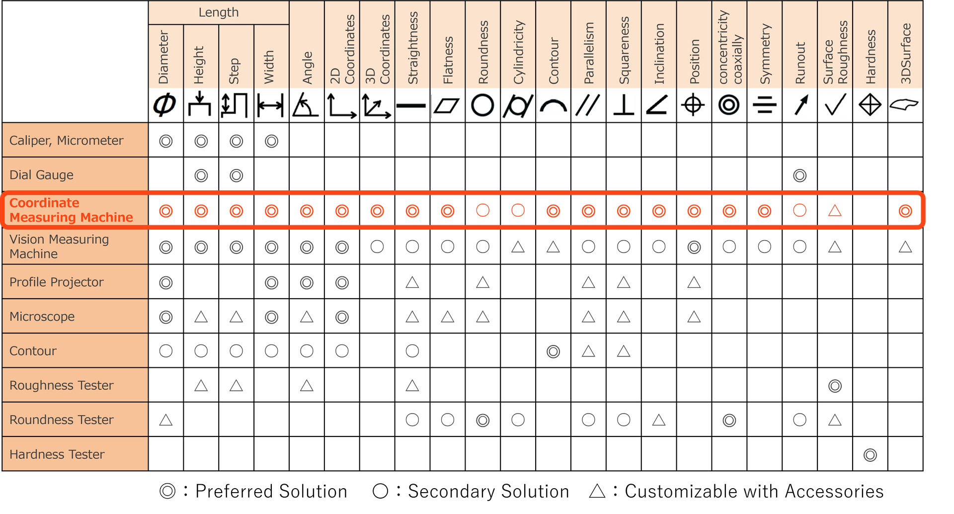

Items Measurable with a Coordinate Measuring Machines
Key Point: A Coordinate Measuring Machine (CMM) can perform a wide range of measurements with a single machine.

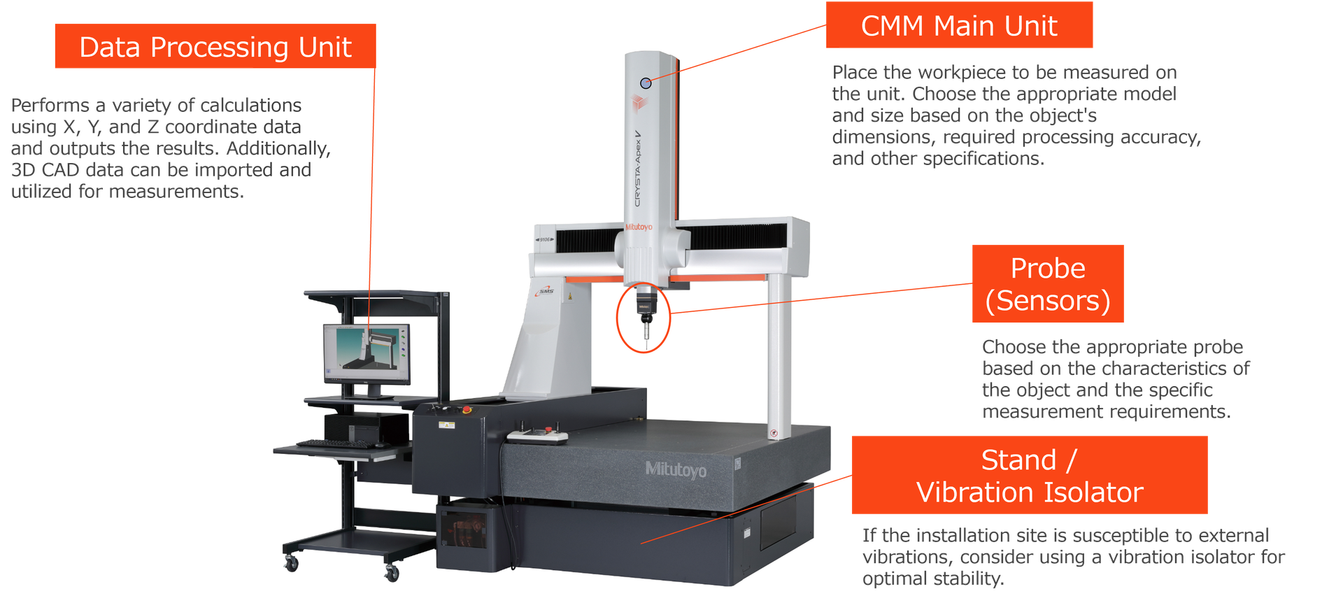

System Configuration

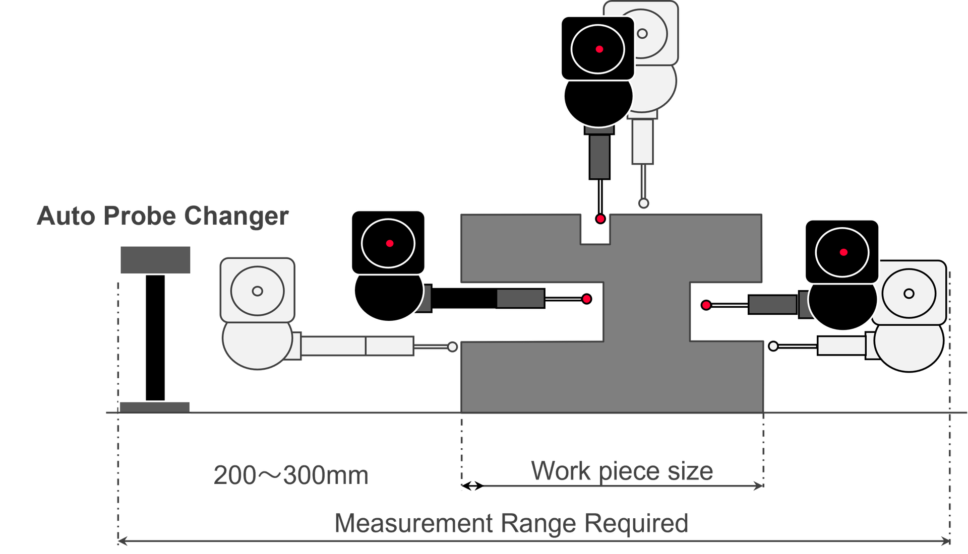

  • Measuring machine body size
    ・The body size of the measuring machine must be larger than the measured object to accommodate the probe's measuring posture.
