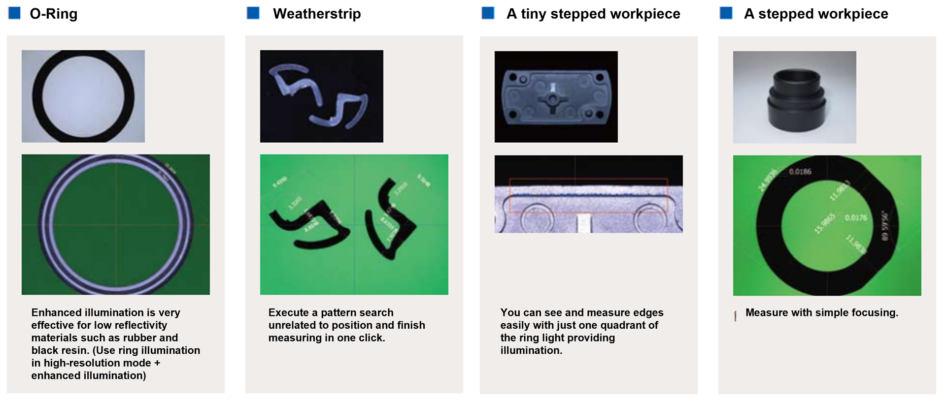

  • Difficulty in identifying measurement points due to hard-to-see edges, especially on materials like white or black resin molded products.

This tool reduces variations in measurement skills among quality inspectors, enhancing overall quality assurance.  Additionally, Quick Image simplifies large batch inspections with pattern search, which automatically detects the number and orientation of workpieces to perform a series of measurements without the need for precise positioning or orientation.  This significantly reduces inspection times and improves efficiency.

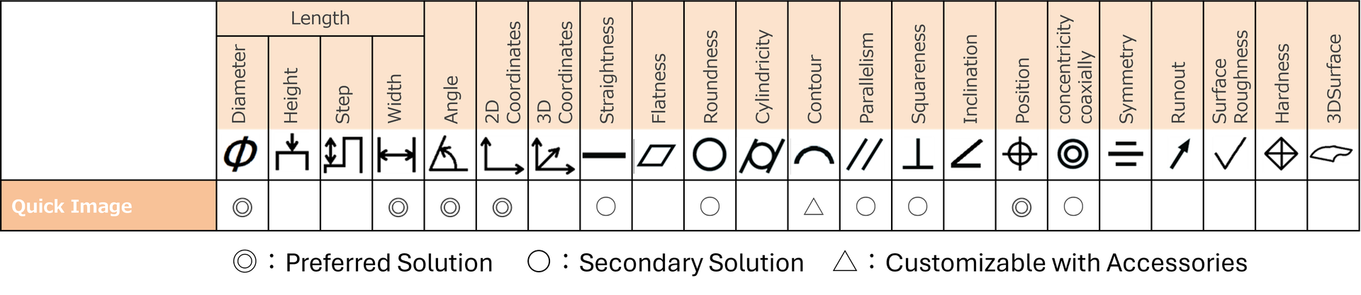

With advanced capabilities to measure angles, PCD, elongated holes, and geometric tolerances, you can significantly reduce setup change times and streamline your inspection process.
Workpieces that are Visually Challenging to Measure can now be Accurately and Efficiently Handled
Are you struggling with measurement points located on chamfered surfaces or challenging white or black resin components—areas that seem measurable only with direct overhead lighting? Have you resigned yourself to manual inspections because no other solution seems to work?
Mitutoyo's Quick Image redefines what’s possible. With its advanced telecentric lens, versatile lighting options, and high-precision edge detection, it delivers crystal-clear measurements, even under challenging conditions. Say goodbye to “impossible” measurement points.
