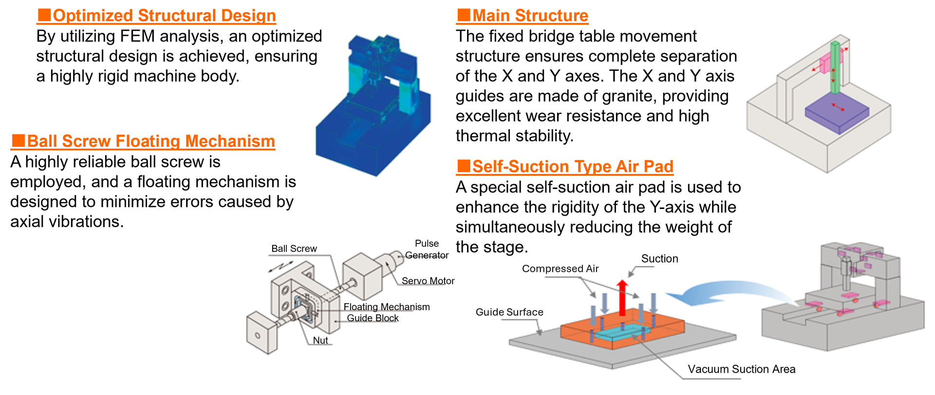

Mitutoyo has set a global benchmark by achieving an accuracy guarantee of 0.35 μm in Vision Measuring Machines, thanks to a meticulously engineered structure that effectively eliminates error factors.

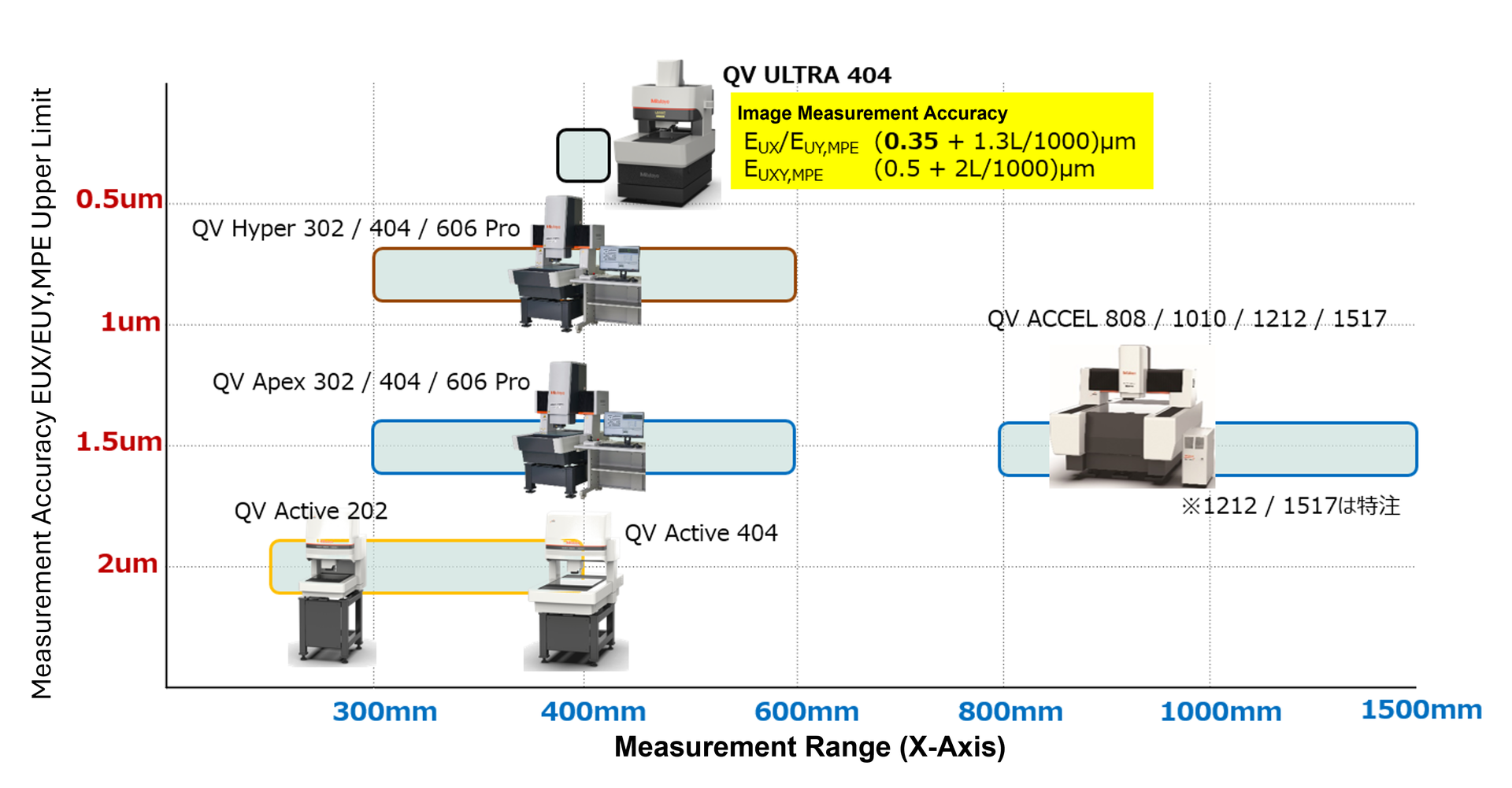

Mitutoyo's line-up of Vision Measuring Machines ranges from general purpose to ultra-high precision
